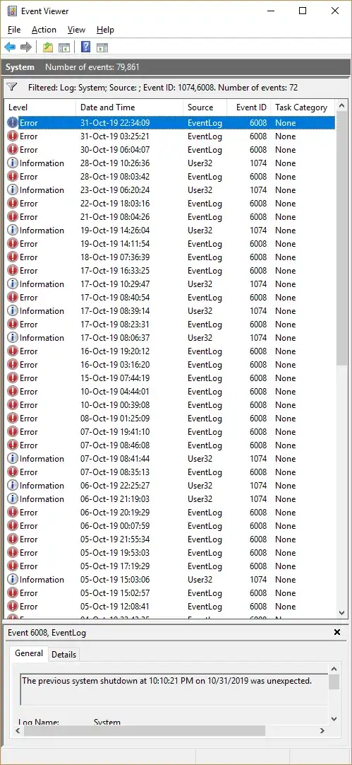

My event log is filled with "unexpected" shutdowns:
All the 6008 sources read the same:
The previous system shutdown at 10:10:21 PM on ‎10/‎31/‎2019 was unexpected.
The log entries from 1074 read:
The process C:\Windows\System32\RuntimeBroker.exe (xyz) has initiated the restart of computer xyz on behalf of user domain\user for the following reason: Other (Unplanned)
 Reason Code: 0x0
 Shutdown Type: restart
 Comment:
So I think those are likely candidates for Windows Update.
