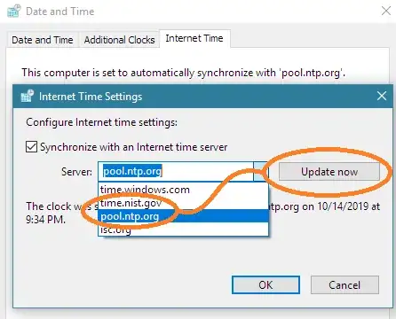

The issue that time.nist.gov fails to synchronize time might be due to timeserver or network latency. The Windows Club has a nice tutorial on setting the time server and adding other servers through the Registry, which are REG_SZ values at HKEY_LOCAL_MACHINE\SOFTWARE\Microsoft\Windows\CurrentVersion\DateTime\Servers.
Set Windows time server
On my PC, about three-quarters of attempts to sync to time.nist.org failed with, "the timeout period expired." However, after adding pool.ntp.org and selecting it, synchronization succeeded consistently. Perhaps NIST is overloaded?

  • I tried this and the clocks on Windows and Linux are now in sync, but I am still unable to sync the time with time.nist.gov. – David Pitchford Oct 14 '19 at 21:31
  • @DavidPitchford, the answer has been amended to show how to add a timeserver. From my own testing, time.nist.gov does not often provide a timely response, but other servers did. It would seem about time for that to be fixed. – DrMoishe Pippik Oct 15 '19 at 01:51
    I tried adding pool.ntp.org and syncing with it, but it also fails consistently because "the timeout period expired". isc.org had the same issue. Are there no working time servers out there? – David Pitchford Oct 18 '19 at 03:08
  • Is there a firewall rule on your network blocking them? Try to ping them. – DrMoishe Pippik Oct 18 '19 at 20:36
