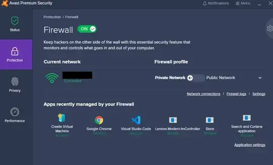

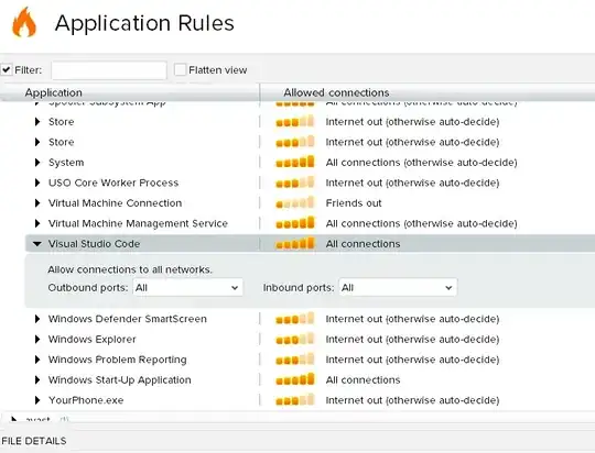

I have checked that VSCode has all connections allowed in all ports (inbound and outbound):
Allowing rules seem to be in place:

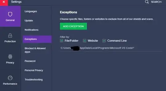

And also added VSCode to the antivirus exceptions list:
None of the actions above worked, only disabling the firewall.

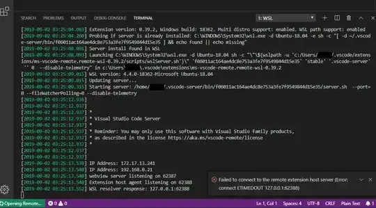

This is the output I get from WSL terminal in VSCode:
Failed to connect to the remote extension host server (Error: connect ETIMEDOUT 127.0.0.1:62388)

  • No luck, same result after adding C:\Windows\System32\wsl.exe to the exceptions list – kerzek Sep 02 '19 at 19:43
  • Try in Avast Settings > Protection > Firewall, to enable "Internet Connection Sharing mode". Or it may be in Tools > Firewall > Settings > Policies. – harrymc Sep 02 '19 at 19:49
  • @harrymc Just tried allowing ICS, no luck unfortunately. I also changed to "Ask" in "For programs with no defined rules.. do the following". But Avast never asks. – kerzek Sep 02 '19 at 19:57

  • I have found and added the paths mentioned to the exceptions list, but the issue persists. I also added the extention's path C:\Users\myUser\.vscode\extensions\ms-vscode-remote.remote-wsl-0.39.2\*. Thanks for your comments. – kerzek Sep 03 '19 at 01:12
  • @kerzek Add the rule for both inbound and outbound in Windows Firewall and Avast both. – Biswapriyo Sep 03 '19 at 17:32
  • I solved all the problem allowing TCP/UDP inboud/outbound for the node executable, in my case "C:\Users\giuse\AppData\Local\Packages\CanonicalGroupLimited.Ubuntu18.04onWindows_79rhkp1fndgsc\LocalState\rootfs\home\developer.vscode-server\bin\b37e54c98e1a74ba89e03073e5a3761284e3ffb0\node" – Neurone Sep 28 '19 at 21:13
  • See here for an example working configuration: https://imgur.com/a/FchzRTu – Neurone Oct 01 '19 at 22:00

  • It's not a problem related to the antivirus, exclusion folders list does not affect firewall. In my case all was solved when I added the rule to allow inbound/outbound TCP/UDP traffic for the WSL node executable, in my case in "C:\Users\giuse\AppData\Local\Packages\CanonicalGroupLimited.Ubuntu18.04onWindows_79rhkp1fndgsc\LocalState\rootfs\home\developer.vscode-server\bin\b37e54c98e1a74ba89e03073e5a3761284e3ffb0\node". Check the answer of @Biswapriyo for more details. – Neurone Sep 28 '19 at 21:16
  • @Neurone: What is your relation to user kerzek? My answer also referred to Avast Firewall, but not being a user of Avast I couldn't be sure of the right folder. And why use Avast Firewall if Windows Defender Firewall is just as good and much better integrated? – harrymc Sep 29 '19 at 06:21
  • The problem with your answer is not the path (and in any case you should not point the whole linux but a single executable file), the difference is when you write "...these are the folders that are need to be exempt in Avast in order to allow the execution of Ubuntu." Antivirus and Firewall are different components in Avast. When you insert a folder in the exclusion list you are excluding from the Antivirus scan, not from the Firewall. To exclude from the Firewall, you need to add an exception to allow inbound/outbound TCP/UDP traffic for the node executable that you find in the folder above. – Neurone Oct 01 '19 at 21:43
