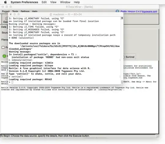

I have it working on OS X 13.6, using, R 4.02, RGtk2 version 2.20.361 and gtk+ version 2.24.32_3 (installed via homebrew):
==> Downloading https://homebrew.bintray.com/bottles/gtk%2B-2.24.32_3.high_sierr
==> Pouring gtk+-2.24.32_3.high_sierra.bottle.1.tar.gz /usr/local/Cellar/gtk+/2.24.32_3: 1,194 files, 59.9MB
After installation,
> library(rattle)
Loading required package: tibble
Loading required package: bitops
Rattle: A free graphical interface for data science with R.
Version 5.4.0 Copyright (c) 2006-2020 Togaware Pty Ltd.
Type 'rattle()' to shake, rattle, and roll your data.
> rattle()
Loading required package: RGtk2
Screenshot of rattle() in R
See also Error in installing packages 'RGtk2' and 'rattle' in R, for other working version combinations of R, RGtk2 and rattle.
To determine which version of gtk+ you have installed, use:
# brew list --versions gtk+
gtk+ 2.24.32_3
To determine which version of RGtk2 you have:
> ip <- as.data.frame(installed.packages()[,c(1,3:4)])
> rownames(ip) <- NULL
> ip <- ip[is.na(ip$Priority),1:2,drop=FALSE]
> print(ip, row.names=FALSE)
         Package   Version
              BH  1.72.0-3
       RGtk2   2.20.36
For completeness, this was the procedure I followed (adapted from Erin Lun's guide listed in Rattle: Installation on Macintosh OS X (Leopard and Lion)):
brew install r
brew install gtk+
uninstall --force cairo --ignore-dependencies
brew cask install xquartz
brew install cairo
R
> install.packages("RGtk2", dependencies = T)
> install.packages("cairoDevice", dependencies = T)
> install.packages("rattle", dependencies = T)
> q()
R
> library(rattle)
> rattle()
Note: I found that the suggested command brew install --with-x11 cairo gave me an error (Error: invalid option: –with-x11)
