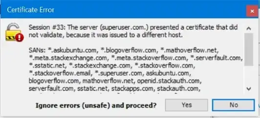

The explanation given by Mokubai is exactly correct, and the problem is in the browser not identifying that this is the same domain and therefore not sending the cookies.
But the situation is even worse: The dot at the end only marks the domain as fully-qualified (unambiguous), which works quite well with DNS, as the message does finally get to the right address (superuser.com).
I have even gotten from Fiddler this dialog for superuser.com. (with dot):

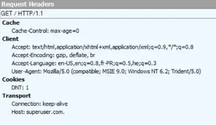

With some empirical testing, here are the headers sent with these two requests.
https://superuser.com (sensitive info crossed out)
https://superuser.com. (with dot, no sensitive info needs to be crossed out)
Conclusion: The problem is with the browser not ignoring a dot at the end of a fully-qualified domain name, as is quite possible by the DNS standard.
Further remark: The browser developers were not the only one to fall in this trap. I have the NoScript add-on installed to stop all JavaScript, but superuser.com (no dot) is allowed through. But NoScript still blocks superuser.com. (with dot) as being an unknown website. I have no doubt that testing would find the same behavior in many other products.
It is strange that the developers from major actors in the Web domain, such as Google Chrome, Firefox and Microsoft's Fiddler, all responsible for many advances in Web standards, have not paid attention to this possibility.
