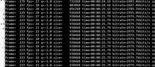

I am using ffmpeg on linux for real time video recording to Youtube. When I put the ffmpeg command, ffmpeg is running well. But, audio device becomes fail, frame count is not increase at all from time of audio device failure. Video record on Youtube is stopped. but ffmpeg command is still running with not increasing frame count as follow image.
My question is that how can I get the status of ffmpeg running at outside of ffmpeg command?
My first solution is that I read frame counter field, if counter is not changed, then something fail on ffmpeg.

  • If ffmpeg fails, it will exit with a corresponding non-zero exit code and the process will be stopped. If it is running, it is running. Or are you specifically looking at the frame count not increasing? Please clarify your question. – slhck Jul 15 '19 at 08:28
  • In my case, ffmpeg is not stopped, remain on running state, wirh same frame counter value. I did as follow link, https://stackoverflow.com/questions/2017843/fetch-frame-count-with-ffmpeg but I can not get frame count value at real time, there are some delay. – Paul Lee Jul 16 '19 at 05:12
  • sorry correct link is https://superuser.com/questions/84631/how-do-i-get-the-number-of-frames-in-a-video-on-the-linux-command-line – Paul Lee Jul 16 '19 at 05:17
If you run ffmpeg with the -progress - -nostats options, it'll print its progress in a parsable format to the output:

Query that output repeatedly from whatever script or shell you are calling ffmpeg from, and watch for lines starting with frame=. If the number does not change, the encoding process is hanging.

    Did the OP say anything about using PHP? Also, it seems he wants to check if the frame count is not increasing, not whether the program has stopped altogether. – slhck Jul 15 '19 at 08:29
  • Even though the frame count is not increasing, ffmpeg does not return, still running. – Paul Lee Jul 15 '19 at 23:55
