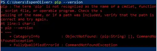

So the next step is to check if I have pip installed, and I'm supposed to type pip --version and as you can imagine I get this:
Adding a directory like I did for python does not solve this problem. How can I check that pip is installed in my computer if I installed python through Anaconda?
It is usually inside the site-packages folder. This is my output:
PS C:\Users\NFR> pip --version
pip 19.0.3 from c:\python37\lib\site-packages\pip (python 3.7)
So, in your case, it should be inside ..\Anaconda3\python\lib\site-packages

You have to tick the box: "Add Python 3.9 to PATH" when installing python.
