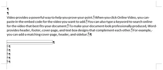

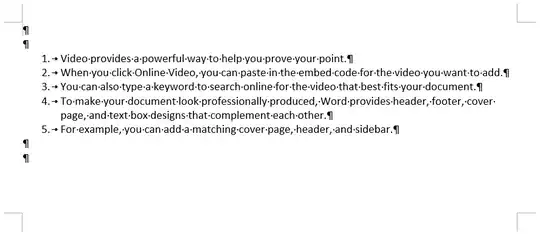

I ran the above on this input:
before
and got this result:
after
