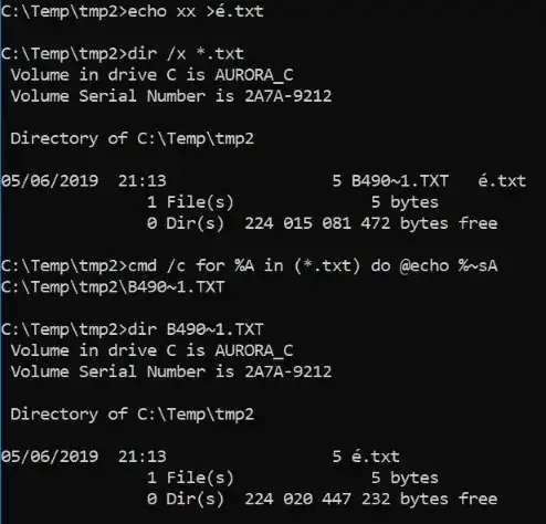

In the meantime, you will need to transform file-names containing non-ASCII characters into names without such characters. This format is called the short form of the file-name, which is basically the old DOS format of the 8.3 file-name. The dir /x command will display these names.
For getting the short names for a bunch of files, see the post How can I find the short path of a Windows directory/file? where various solutions are listed. I especially liked this answer that proposed the following one-liner:
cmd /c for %A in ("C:\Program Files") do @echo %~sA
Here is an example on how you may use it:
