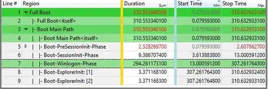

According to Windows Performance Recorder, my Winlogon phase is taking 290 seconds to complete:
(WPR image)
This thread suggests that it is a HDD bottleneck, but my OS is installed on a 240 GB SSD from Kingston. So I believe something else might be the problem. Any ideas? I have a secondary HDD, but I already tried to boot without it plugged in and the issue persists. Also, my SSD is half empty, so that shouldn't be a problem.

I´ve tracked a few misbehaving processes. Here are some that i think might be the problem. Note how the wermgr.exe process finishes at 159 seconds. Then the sppsvc.exe process starts (likely due to a dependecy) and then the sppsvc.exe process ends at 191 seconds, roughly the end of my winlogon phase. (I've done another WPR trace and the winlogon phase took 192 seconds, just as a FYI).
  • What's happening in that boot phase? Drill down into the data to find what's taking so long. – I say Reinstate Monica May 25 '19 at 23:48
  • @TwistyImpersonator I´ve tracked a few misbehaving processes. Here https://imgur.com/a/M21k1yb are some that i think might be the problem. Note how the wermgr.exe process finishes at 159 seconds. Then the sppsvc.exe process starts (likely due to a dependecy) and then the sppsvc.exe process ends at 191 seconds, roughly the end of my winlogon phase. (I've done another WPR trace and the winlogon phase took 192 seconds, just as a FYI). – Pedro S. May 26 '19 at 00:12
  • Please do not only respond in the comments. Instead, [edit] the post with this information. – I say Reinstate Monica May 26 '19 at 00:20
  • Sorry about that, fixed it! – Pedro S. May 26 '19 at 01:11
  • What antimalware is running? Often, boot is delayed until disks, even other HDD's, are scanned. You can check that by temporarily disabling the software, – DrMoishe Pippik May 26 '19 at 03:59
  • i don't have any antimalware (besides windows defender) running. – Pedro S. May 26 '19 at 18:48
