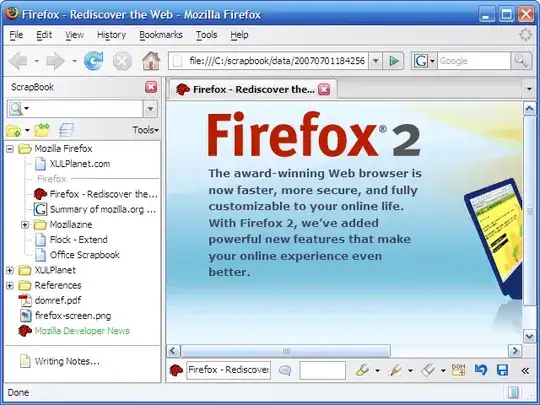

You should take a look at ScrapBook, a Firefox extension. It has an in-depth capture mode.
Gareth
  • 18,809

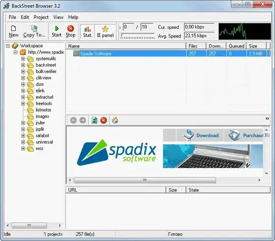

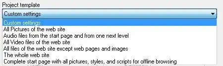

Try BackStreet Browser.
It is a free, powerful offline browser. A high-speed, multi-threading website download and viewing program. By making multiple simultaneous server requests, BackStreet Browser can quickly download entire website or part of a site including HTML, graphics, Java Applets, sound and other user definable files, and saves all the files in your hard drive, either in their native format, or as a compressed ZIP file and view offline.
Gareth
