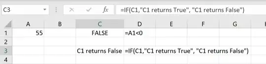

The IF statement only needs something that returns TRUE or FALSE for the condition. So, if you have a formula in cell C1 that evaluates to TRUE or FALSE, then you can refer to C1 as the condition. You don't have to "copy" that condition into the IF statement.
See the screenshot. C1 has a formula that returns either TRUE or FALSE. Cell C3 has an IF statement that uses only a reference to C1 as the condition.
=IF(C1,"C1 returns True", "C1 returns False")

  • Thanks teylyn - for both the quick turnaround and the cool solution. I realized that I would have to drag this formula down. Ie in cell A2 I would have a similar number that i need to assess. Is there a way to drag this down, other than using a support column? [ie separate the A1 or A2 from the "<0" part?] - I think a support column with A1<0, A2<0 ... may work, but there may be a smarter way i suppose – Ashwin Kurian Apr 17 '19 at 12:11
  • Yes you can drag the formula down. How the formula behaves will depend on how you define the references. You never mention dragging down in your question. Please edit your question to include this additional requirement. Also, add a data sample and the expected result mocked up manually. Then post a comment here, so I can see you have updated your question. – teylyn Apr 19 '19 at 04:44
