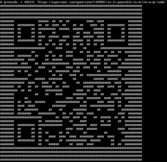

qrencode -t ASCIIi 'https://superuser.com/questions/1420001/is-it-possible-to-write-a-qr-code'
Note: I used -t ASCIIi (Inverted ASCII) because my terminal is White-on-Black.
This mode works by setting the background color to black or white, and printing a number of space characters.

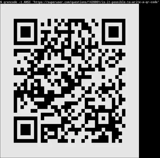

qrencode -t ANSI 'https://superuser.com/questions/1420001/is-it-possible-to-write-a-qr-code'

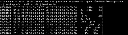

Some of the raw characters written to the terminal are shown below, these are ANSI escape codes. An "escape" character has a value of 0x1b and can often be written as \e.
\e[40m sets the background color to black\e[47m sets the background color to white0x20 is an ASCII spaceThere is also a UTF-8 mode (-t UTF8). This mode uses the "half block" characters to increase the density, and cut the line count by half.

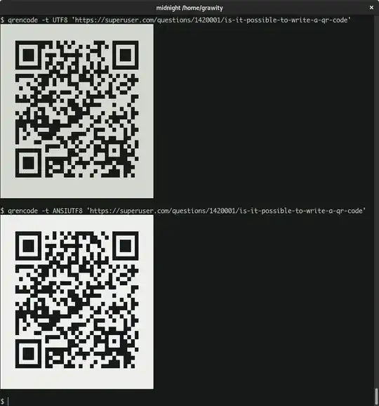

Screenshot from @grawity (thanks)
qrencode -t UTF8 'https://superuser.com/questions/1420001/is-it-possible-to-write-a-qr-code'
qrencode -t ANSIUTF8 'https://superuser.com/questions/1420001/is-it-possible-to-write-a-qr-code'
