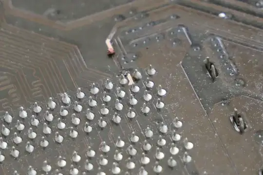

Pulled out the motherboard and found this on the back ;-(
I think I must have turned the computer on with one of the DIMMS in backwards, or not seated all the way. Anyway It's an old board so I found a replacement of the same motherboard with a much faster processor then what I had previously on ebay for $60.
