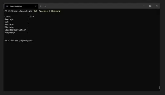

You could use PowerShell for this.
To get a list of all active processes on the local computer, use this command.
Get-Process | Measure

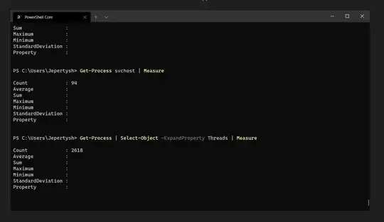

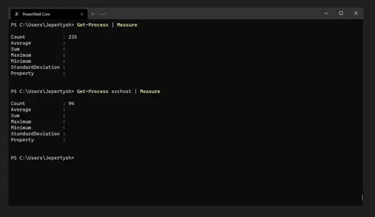

You can also filter these results. For example, see the below code.
Get-Process winword, explorer | Measure
To get no of threads, run this command.
Get-Process | Select-Object -ExpandProperty Threads | Measure
