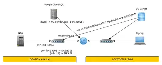

What I'm trying to achieve: Make my sql server publicly reachable so the Google CloudSql can replicate the database.
I have a NAS running debian behind a router that can do port mapping at location A I am at location B with an CentOS VM running mariadb
From the VM at location B I run the following command
:~$ ssh -f -N -T -R 3306:localhost:3306 my.dyndns.address -p [sshport]

On the router I have port 33006 forwarded to the nas's port 3306 like so:
(columns protocol, external-start-port, external-end-port,local-port,destinationport forwarding router Other port forwarding rules like openvpn and ssh work perfectly that way

--- Clarification ---
  1. I want to connect from the outside to my.dyndns.address at port 33006.
  2. my.dyndns.address translates to the public address from my ISP modem.
  3. 33006 is forwarded on the modem to the local IP of the NAS at port 3306, which is in turn tunneled to the mysql-server (at location B).
  4. I'm testing this with
    mysql -h my.dyndns.address --port=33006 -u myuser -p
    whereas
     mysql -h local_ip_on_B -u myuser -p
    works just fine
I also tried using a VPN from the db server at location B to location A (the NAS is also the OpenVpn server) and pointing the forwarded port on the ISP's modem directly to IP Address of the IP the db server gets on the tun interface. If I make a second VPN connection to location A, I can connect the database using the IP from the tun interface from my computer.
The error I'm getting is ERROR 2002 (HY000) Can't connect to MySQL server on ip_of_the_nas.
UPDATE
I made a schematics to clarify my situation further: Overview of the networks
Can someone help me ?
