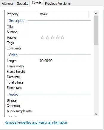

I'm looking to remove ALL metadata, including length, bitrate, etc. Before you say this isn't possible, yes it is, and I have multiple files that have what I'm looking to do. The files without metadata are still fully playable.
Example of what I want to do:

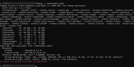

    What did you try with ffmpeg? Share the output of ffmpeg -i nometadata.webm – Gyan Jan 24 '19 at 04:38
  • Output of ffmpeg is https://i.imgur.com/mHXXVd1.png on the file without metadata.

  • What is the tool you're using to view metadata in the first screenshot? Have you created the file, or where did you get it from? Why would you even want a file that has no indicated length or bitrate? – slhck Jan 24 '19 at 08:46
  • @slhck It's just right-clicking on the file and clicking details on Windows 10. Can't remember where I found it. – John Texas Jan 24 '19 at 09:21
