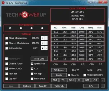

You could try the tool ThrottleStop, which does exactly what the name suggests.
ThrottleStop 8.70 screenshot
Word of caution: 70 degrees Celcius is not too hot, but it is hot enough to potentially damare your laptop. You might consider a desktop computer, which is generally better equiped for prolonged high loads.
Finally a recommendation from the ThrottleStop website:
When using ThrottleStop, it is strongly recommended to monitor power consumption at the wall with a Kill-a-Watt meter or similar device and make sure that you don't exceed the power capabilities of your power adapter. Use of ThrottleStop to bypass these throttling schemes is at your own risk and can result in permanent damage to your power adapter or computer or both which may not be covered by your warranty.

  • I tried throttle stop, which I undervolted by -100mV and set the speed shift EPP to 156. The game performance with the program showed around 2.4GHz without a noticeable clock speed drop, which was okay, but running the game with 2.4GHz was slower than 3.38GHz and definitely not satisfied.. – Felix Lee Dec 21 '18 at 20:07
