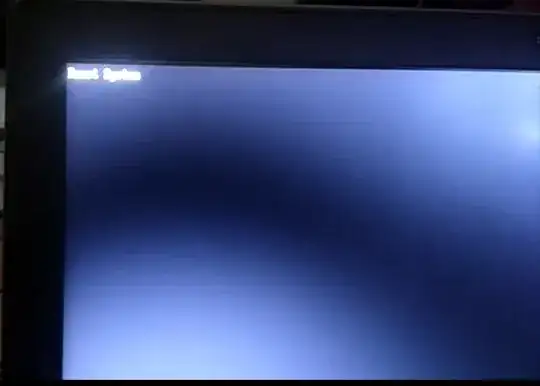

I own a ViewSonic VA1931wa-LED monitor which has a native resolution of 1366x768 pixels with a refresh rate of 60Hz. The problem is that no matter what I do, it works just fine on Windows but on any Linux distribution it can't work properly. I have experimented both with the proprietary nvidia driver (my GPU is an nvidia GeForce 210) and with the nouveau driver and the resolutions I get which are closest to the native one are 1368x768 and 1360x768.
I have also tried typing gtf 1366 768 60 in the terminal and the output is the following:
    # 1368x768 @ 60.00 Hz (GTF) hsync: 47.70 kHz; pclk: 85.86 MHz
Modeline "1368x768_60.00" 85.86 1368 1440 1584 1800 768 769 772 795 -HSync +Vsync
As you can clearly see even though I type in 1366 horizontal pixels I get 1368 as an output. So, is there a way to force my monitor to display its native resolution? If not then what else can be done?
