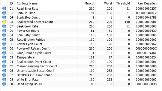

Edit: Added S.M.A.R.T data below.

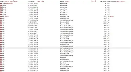

Edit: Added Event Viewer Info (Only Errors) Below:

  • Check S.M.A.R.T. data of the disk using a utility such as Speccy

  • @harrymc Thanks for exactly understanding the situation instead making assumptions before! I've checked the Event Viewer but there are so many information including errors, warnings and infos. Is there any specific type that I should care about? Or any source that I can check the errors & warnings because I couldn't find the reasons of some of them on Google.

  • Include in your post at least one screenshot of errors from the Event Viewer, just for me to get a feeling for it. – harrymc Nov 12 '18 at 11:57

  • Checking S.M.A.R.T data via CrystalDiskInfo showed me a warning about "Reallocated Sectors Count", threshold is 140, the value is 200. – My name is name Nov 14 '18 at 14:20
  • It usually means you had 200 bad sectors on the disk that were mapped to spare sectors. This is not good. Maybe you could post a screenshot of all the values. – harrymc Nov 14 '18 at 14:23
  • I've included it in the original question right now. – My name is name Nov 14 '18 at 14:31
  • Nope, it seems like after all you had only one reallocated sector, which isn't too serious. The disk seems ok, so it looks more and more like an infection. Could you please add a screenshot of the list of errors in the Event Viewer? – harrymc Nov 14 '18 at 14:46

  • Just one screen of the errors list to start with. – harrymc Nov 14 '18 at 14:51
  • Included them as well, sorry for my OS language I tried my best to make translations on thescreenshot. – My name is name Nov 14 '18 at 14:58
  • I only included the first screen of errors in the "System" section adding just in case if it matters. The power errors are probably due to BSODs I started to get recently but I think it's completely an out of subject error. – My name is name Nov 14 '18 at 14:59
  • It doesn't still encourage confidence in your computer. I think it's time for some deep anti-virus scanning before passing to more consequent operations. You are a careful person, as we all try to be, but better be sure before we deploy the big guns. – harrymc Nov 14 '18 at 15:08
