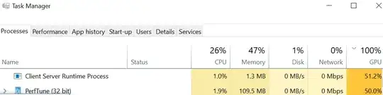

I look at task manager and I see high GPU usage
Look at the process:

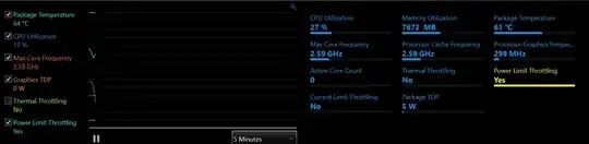

Then I look at Intel(R) Extreme Tuning Utility: note that "power limit throttling" is enabled

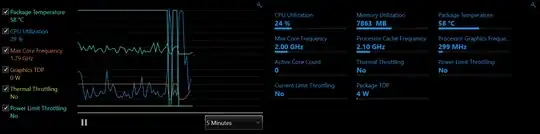

Now I unplug my power cable from the laptop and this happens. The "power limit throttling" is disabled.

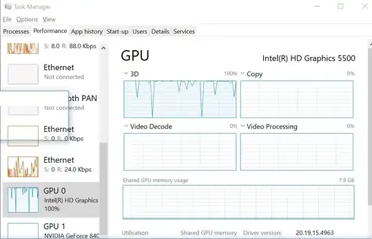

Now I look at task manager

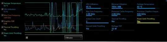

"power limit throttling" is still enabled but pc is fast. I'm not sure what is the problem.

Driving the GPU continuously at almost 100% capacity will heat it up, and depending on the case, may also heat the hardware around it. Most modern CPUs will slow down when the temperature is too high, and some will not return to normal performance without reboot. This seems to be your case.
However, it is not normal for the GPU to run that way. If this is a program of yours that does it, you should put some limits on its use.
If it is not your program, check that the Client Server Runtime Process is running from the system : In Task Manager right-click it and select "Open file location". Explorer should open to the C:\Windows\System32 directory where the program is called csrss.exe. You may get more detailed information by using Process Explorer. If it is not the right one, then your computer is infected and is probably busily mining crypto-currency.

  • I'm not using "CPU+GPU", just normal webdevelopment (file watchers) and browsers. GPU looks to be used by Windows to show the actual square windows. Not sure how to improve cooling in my laptop, but that looks like another kind of problem. The thing is this behaviour was not happening before, my pc could handle this tasks without power throttling. "Intel Dynamic Platform and Thermal Framework" is the reason of the power limit, and from reading online looks like has some buggy behaviour. Limits when the temperature of the pc is 80 degrees c. I don't know how to fix it... – Totty.js Oct 26 '18 at 06:26
