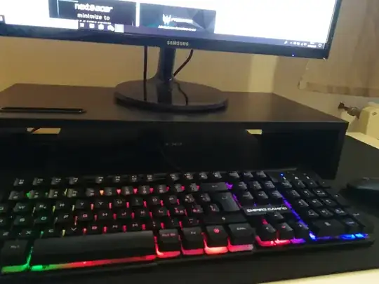

here is my situation: I have an Aspire A315-41 that I use with an external monitor and an external wired keyboard. The laptop is closed and positioned below the monitor stand. I want to specify that I googled for 2-3 days before posting this question, but I didn't find any possible solution.
So basically what I'd want to do is to power on the pc from a state that can be the standard shutdown or an hibernation (NOT sleep nor hybrid sleep), without pulling out the laptop, opening it and press the power button. I tried every possible configuration to wake the system pressing a key with the external keyboard (which would have been the best solution), but none worked: the usb ports are powered off, so hitting any key does nothing. I think I'll have to stand to the idea that this is just not possible.

setup
