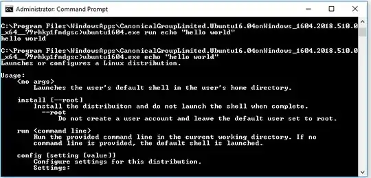

  2. Returns a form of documentation on how to Launch a Linux distribution (attached in picture below).
  3. Returns hello world but does not open WSL ubuntu.
  4. Opens Ubuntu in the location of the current cmd path, but does not execute
Documentation received in command 2.
