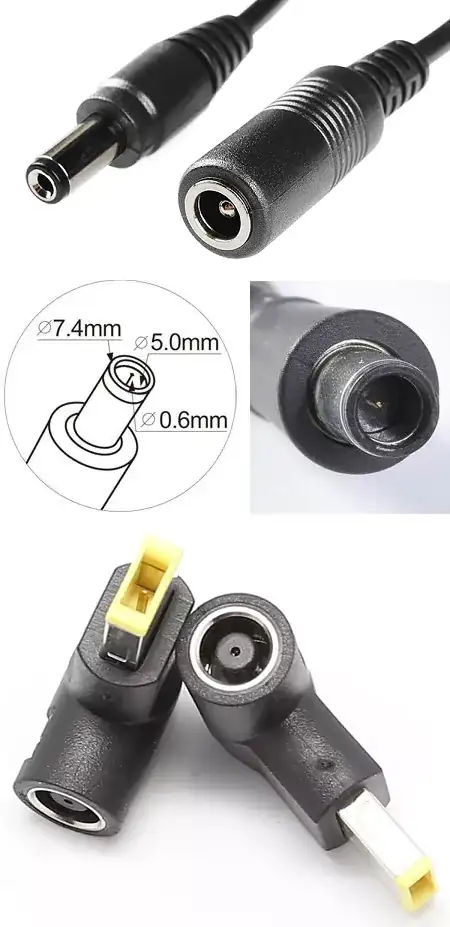

  • Connector - The most common DC connector is a "barrel jack", but there is a range of sizes (both outer diameter and pin) that can make things frustrating. There are a number of standards to help designers select the correct size connector for the voltage / current (and thus ensure that nothing too drastic goes wrong), but they are rarely adhered to. Also, larger manufacturers (e.g: Dell / HP / Lenovo) do funny things like put the pin on the "other" end, providing a third conductor, or use a square USB-shaped connector.
power connectors

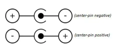

  • Polarity - Something that is often missed is that the connector will have a polarity - e.g: the center of the barrel will be positive, and the outer surface will be negative. If you get a replacement power supply with the incorrect polarity, then you'll effectively be providing a negative voltage (-20v) instead, which will most likely cause permanent damage immediately. While center-positive is very common, it's not exclusive. Look for a symbol like these:
polarity symbols
