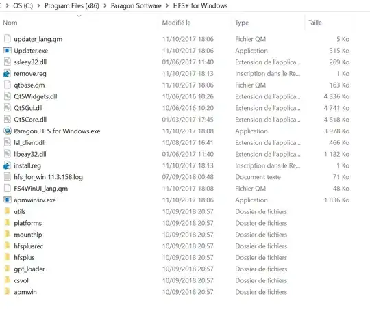

Finally, there is a screenshot of the content of the install :
paragon
As you can see there is a reg modifier so I'm afraid that my register was modify. and if I look on all subdirectories, there is nothing talking about an uninstaller.exe

I contacted paragon and they gave me this solution (that worked on my paragon so, GOOD LUCK!)
  1. Launch HFSCleaner-2.exe as Admin, let it perform its task, then reboot PC when prompted.
    • HFSCleaner-2.exe received from Paragon Support
  2. Delete these files from C:\Windows\system32\drivers:
    • apmwin, apmwinsrv, csvol, gpt_loader, mounthlp, hfsplus, hfsplusrec
  3. Install latest HFS4Win
