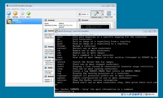

73
This is built into VirtualBox 4.2.
Simply hold down Shift when launching the VM from the Manager.
https://blogs.oracle.com/fatbloke/entry/what_s_new_in_oracle
    Update : in VirtualBox 5.1 you even have a drop-down start menu just right of the start button in the manager. This menu is available only if the VM is stopped. – Titou Mar 27 '17 at 08:49
