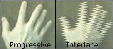

progressive vs interlaced
As mentioned earlier, modern resolutions are still referred to by their "line count". But as shown above, we also have to identify whether we are referring to "interlaced" video (indicated by an i), or "progressive" video (indicated by a p).

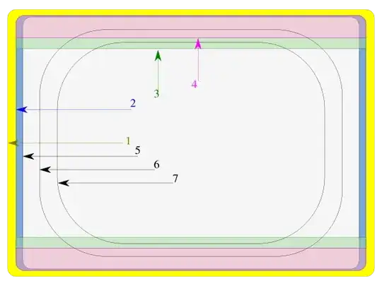

As a little extra, I've included the graphic below to expand on the "image changes shape" statement from above.
The graphic (from here) indicates the various "television safe" areas... note the rounded corners...
Importantly:
  • 5 is the "television scanned area"
  • 6 is the "television safe area for action"
    • Faces and important plot information should not fall outside this area
  • 7 is the "television safe area for titles"
    • No text should be outside this area to ensure that subtitles / news tickers / etc... don't overhang the edge of an old display
display safe areas

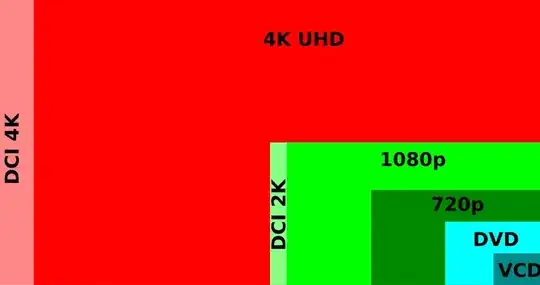

Attie has explained how vertical pixel counts were derived for traditional resolutions such as SD (480p), HD (720p) and Full HD (1080p). I would like to discuss K measurements which originate from the cinema industry. A K is about 1000 horizontal pixels and 2K and 4K were casual terms referring to resolutions of approximately 2000 and 4000 horizontal pixels.
Different K measurements were later standardised for digital cinema (2005) and consumer television (2007).
Digital Cinema Initiatives has specified the DCI 4K and 2K resoultion standards (4096 × 2160 and 2048 × 1080). These are the full frame resolutions for digital cinema projectors, with many films displayed in the a crop format such as flat crop (3996 × 2160 , 1.85∶1 aspect ratio) or CinemaScope crop (4096 × 1716, ≈2.39∶1 aspect ratio).
The 4K standard for consumer television (UHDTV1) can be more accurately labelled as Ultra HD or Quad HD. It is equivalent to 4 Full HD frames placed together. It is 3840 × 2160 with ≈1.78∶1 aspect ratio.
The Wikipedia article on 4K resolution provides a helpful visualisation which compares different frame sizes.
Comparison of video frame sizes
