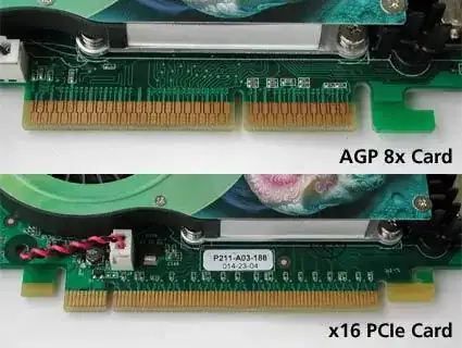

Consider this image of the slot part of two cards, a PCIe 16x graphics card (bottom) and an AGP 8x graphics card (top):
They have the following distinctive features:
  • L-latch height: AGP cards' back-L "latch" extends all the way down to the same level as the connector pins; with PCIe, the latch is shorter.
  • Pin pattern: The AGP card has a sort of a zig-zag pattern where subsequent pins are at different heights; PCIe pins are all parallel to each other.
  • Position of slit: The PCIe connector pins are split by a slit in the PCB close to the panel-side of the card (where the output connector is), while the AGP card's similar slit is much further away from the panel (beyond the half-point).
Notes:
  • You can't trust various other differences, like having/not having pins on the L-latch.
  • Even if you're sure you've correctly identified the type of card, be very careful when inserting it into the socket and refrain from applying more than a little bit of pressure to avoid damaging the hardware.

    Isn't AGP slot also offset differently with respect to the mounting bracket/case knockout? – Yorik Jul 11 '18 at 17:01
