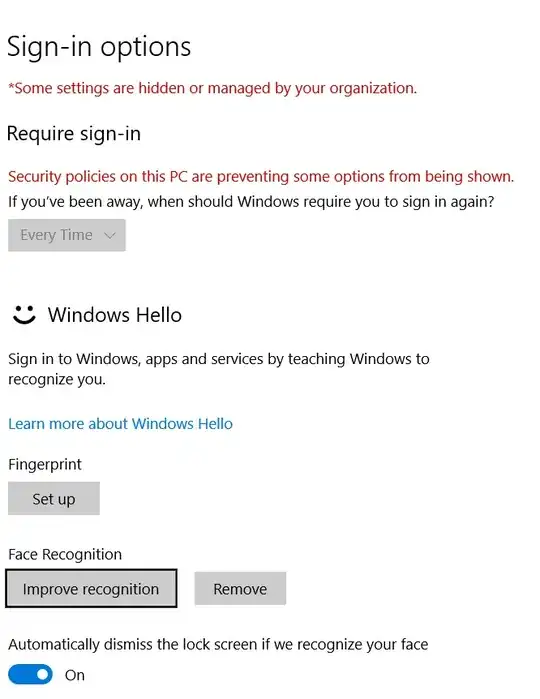

Here is the settings screen: enter image description here

  • Are you using Hello for Business, of Windows 10 Hello? – music2myear Jun 28 '18 at 15:21
  • @Ramhound yes it works fine from my local account – blizz Jun 28 '18 at 15:46
  • @music2myear I'm just trying to enroll to Windows Hello that's available on my laptop in the settings...I added a screenshot of the settings screen – blizz Jun 28 '18 at 15:47
My solution ultimately was to delete the NGC folder here: C:\Windows\ServiceProfiles\LocalService\AppData\Local\Microsoft\NGC
That cleared out the previous biometrics data attached to my user profile and allowed me to configure it all from scratch and it works great now!
