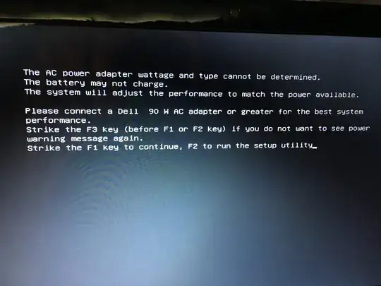

When the laptop bios (or uefi) cannot determine the type of charger plugged in, it'll show you a warning message letting you know of this. You can ignore this message, or investigate what's happened to your charger that it's now not providing the correctly expected power.
Dell Adaptor warning
Your issue with the laptop down clocking can be due to a number of factors including power saving settings (Did you click onto 'maximum battery'?), the laptop detecting that in the incoming power is insufficient to run at maximum speed, or a overheating issue causing it to under clock to protect the hardware.
However, as you recall seeing the AC Power Adapter warning, it's likely this is the issue - when buying a replacement PSU make sure you get one that can do the maximum power for your laptop.
