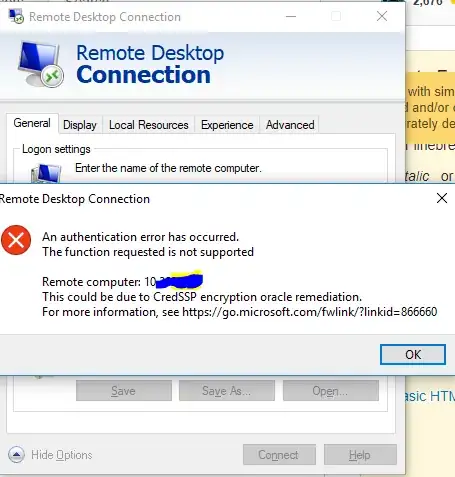

After Windows Update, I get this error when trying to connect to a server using Remote Desktop Connection.
When read the link provided by error message, it seems because of an update at 2018/05/08:
May 8, 2018
An update to change the default setting from Vulnerable to Mitigated.
Related Microsoft Knowledge Base numbers are listed in CVE-2018-0886.
Is there a solution for this?

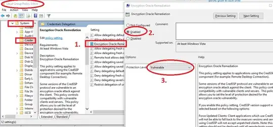

I found one solution. As described in the help link, I tried roll back from update 2018/05/08 by changing the value of this group policy:
  • Run gpedit.msc
  • Computer Configuration -> Administrative Templates -> System -> Credentials Delegation -> Encryption Oracle Remediation
Change it to Enable and in Protection level, change back to Vulnerable.
I am not sure if it may rollback any risk of an attacker exploiting my connection. I hope Microsoft will fix this soon so I could restore the setting to the recommend setting Mitigated.

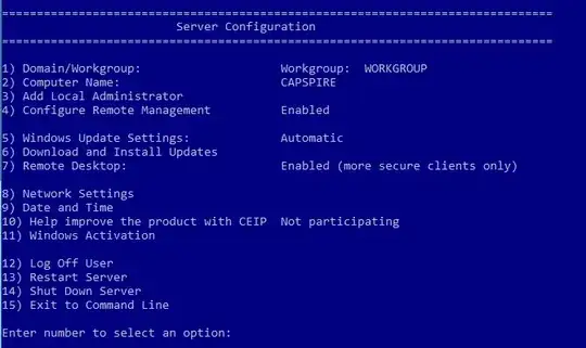

Another option if you have access to the command-line (we have an SSH server running on the box) is to run "sconfig.cmd" from the command line. You get a menu like below:
Enter image description here
Choose option 7, and turn it on for all clients, not just secure.
Once that's done, you can remote desktop in. It looks like for us the problem was our client systems got updated for the new security, but our server boxes were behind on updates. I'd suggest getting the updates and then turning this security setting back on.
