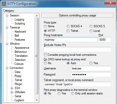

Outgoing Proxy configuration:

In the device that I am running SSH command, I am going out with via a proxy server. Is that affecting the reverse tunnel behavior?

If you have specified a proxy then in some cases you need to add the local IP address (192.168.1.132 in this example) to the "excluded hosts/IP address" list in the proxy settings panel. Otherwise the reverse ssh connection going through putty will try to connect to the local IP address using the proxy.
