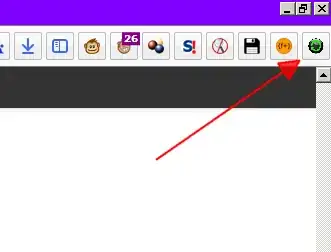

I want to quickly restart Firefox, not losing any tabs that are still open before the restart.
Use the Restart Browser add-on:
Allows to restart the browser with a button.
Confirmed as working with Firefox 61.0.1:
DavidPostill
  • 156,873
  • thanks, i think it didn't exist at the time of my question. I got so used to F2 that I didn't bother to look! This is better! - Thanks again! – Albin Jul 18 '18 at 10:42
