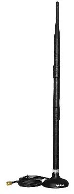

The Question: I am wondering if I could swap the Netgear's crappy built-in antennas for a pair of mag-mount WiFi antennas (with SMA connectors and 2 meter long coax cables). This means I can run the coax through the wall of the garage and place the antennas a couple of meters apart on the roof of the garage (there's a magnetic steel strip on the roof that holds down the waterproof membrane) I can stick the antennas to that metal as a ground plane. This would neatly side-step the steel door I believe.
enter image description here + enter image description here enter image description here
I've already taken the device apart to see if it has U.FL antenna connectors (it does), and I have some U.FL to SMA connectors ready.
Is this a bad idea? Is this likely to destroy the RF stage of the WiFi transceiver? One one hand I know that antennas need to be compatible with a transceiver, but on the other hand the Netgear will have the cheapest possible antennas built-in and will probably not be the best way to get optimum WiFi signal. I have no budget, I'm having to use parts at my immediate disposal.

  • How many meters from the house? Ethernet cable is good for 100m (provided you enclose it in waterproof ducting) ... – DavidPostill Dec 21 '17 at 14:15
  • About 20 meters. Unfortunately I'm not able to run cabling out there, I'll edit my question. – Wossname Dec 21 '17 at 14:16
  • If the antennas can be removed then you can’t destroy it by using different antennas – Ramhound Dec 21 '17 at 14:47
  • @Ramhound, they can't be removed without taking it to bits. That's what I'm trying to decide upon. – Wossname Dec 21 '17 at 14:51
  • This is a very good answer, this is also, and this is as well. – u1686_grawity Dec 21 '17 at 15:40
  • You'd probably violate FCC regulations by using an external antenna (not a high risk of prosecution), and it may not work, but it is unlikely to destroy the RF amplifier in the WiFi extender. A better solution is to use ethernet to a better location for the WiFi extender and find a way to waterproof mount it. The best solution would be to run a wired connection from the router to the garage. Have you considered aerial cables? – davidmneedham Dec 21 '17 at 15:56
