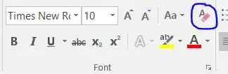

What worked for me was just select all the text in the word file and click on Clear formatting:
screenshot of tool
