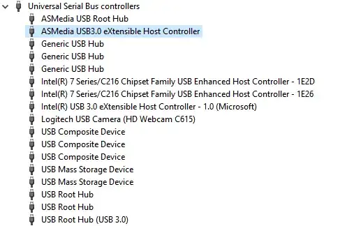

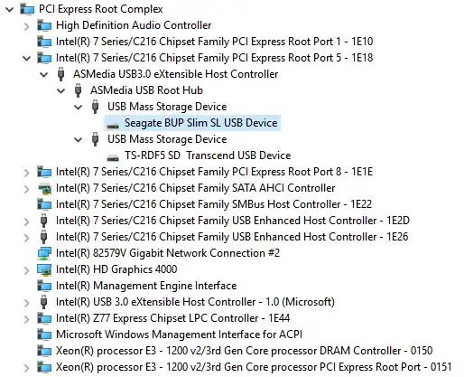

  • Can you provide the information on each by submitting a screenshot of the device manager similar to this question. Do not submit this information as a comment. – Ramhound Nov 29 '17 at 17:35

  • Based on the evidence you have provided, the device is connected to the USB 3 host controller, which means the problem likely falls to the device itself. If you disconnect all USB devices except your keyboard and mouse, does the device still, negotiate itself at the improper speed? Additionally do any other USB 3 devices negotiate the improper speed? – Ramhound Nov 30 '17 at 15:10

  • It's still not solved unfortunately. I downloaded the latest driver but can't install it as Windows tells me I already have them installed. But that USB Device Tree Viewer reveals it's not the latest version. Damn windows autoupdate will not find the latest driver. If I supply it manually it rejects it. – Firsh - justifiedgrid.com Jan 10 '18 at 17:16
