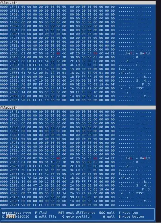

There's a tool called DHEX which may do the job, and there's another tool called VBinDiff.
For a strictly command-line approach, try jojodiff.
njd
  • 11,206
    DHEX is awesome is comparing binaries is what you want to do. Feed it two files and it takes you right to a comparative view, highlighting to differences, with easy ability to move to the next difference. Also it's able to work with large terminals, which is very useful on widescreen monitors. – Marcin Sep 08 '11 at 00:08
    I prefer VBinDiff. DHEX is using CPU even when idling, I think it's redrawing all the time or something. VBinDiff doesn't work with wide terminals though. But the addresses become weird with wide terminals anyway, since you have more than 16 bytes per row. – Janus Troelsen Oct 17 '12 at 14:22
    vbindiff lets us actually edit the file, thx! – Aquarius Power Sep 16 '14 at 18:28

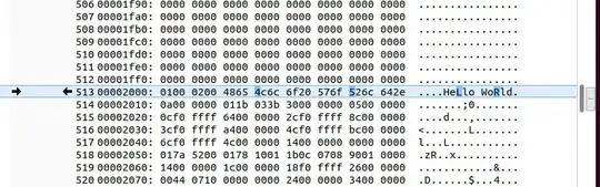

The first command above gives you this view, highlighting the exact differences, on a line-by-line and character-by-character level, between the left and right files. Notice the highlighted slivers in the right scroll bar too, which indicate where lines differ in the entire file:

    Here's a screenshot so you can more easily see the colored changes:

    Here's what it looks like on the 2nd change shown above. As you can see, it has highlighted the exact character differences in red. It's a pretty nice tool:
    Navigation:
    1. See man vbindiff for details. It's a short and easy manual.
    2. Press Space or Enter to go to the next difference. I hit Space twice to go to the 2nd difference in the screenshot above.
    3. Press Q or Esc to quit.
    4. You can scroll with the mouse scroll wheel, arrow keys, PageUp/Down keys, etc.
    5. Press T to toggle on scrolling only the top window.
    6. Press B to toggle on scrolling only the bottom window.
    7. Press F to find.
    The navigation is really pretty limited. I don't see a way to go back up and find a previous change. Just quit and start again.

Then, of course, compare them!:
meld <(xxd file1.bin) <(xxd file2.bin)
