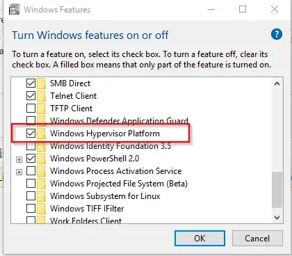

Finally, I also had the same experience that none of the solutions available seemed to work, until I noticed this option was turned off. Enabled Windows Hypervisor Platform, and 64-bit in VB is now available!
