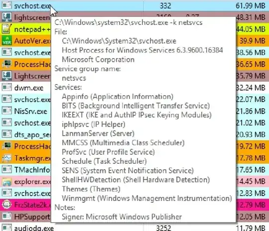

I have a 64bit Windows 8.1 system operating under Deep Freeze and most of the time it is very very very stable. However at random intervals one of my processes, one of the many system svchost.exe instances, suddenly starts grabbing massive amounts of Private Bytes according to Process Hacker. Typically the process floats between 20MB to 80MB of memory but when this problem pops up it rises to about 1.5GB in less than 5 minutes and stays there for a while then just as suddenly starts to drop memory until it hits about 200-300MB and stays there a long time. Eventually it goes back to the normal range. Honestly I would not care much except that when that much memory is consumed the system comes to a crawl making many applications non-responsive and sluggish.
Using Process Hacker I can provide the following information:
The process command line is:
C:\Windows\system32\svchost.exe -k netsvcs
and the executable has been verified as Microsoft version 6.3.9600.16384
The services running under the process are:
What I want to know is how can I identify the specific service out of this list? Based on some filenames I have seen after the process starts dropping back down I suspect it may be that Windows is trying to update something but I have all automatic updates turned off since it makes no sense to try and update a frozen system. If Windows is doing something that I am not aware of then it is an off-the-books activity.

  • Ok, I see your screenshot now. You can't see the windows update process because it is not currently running and your memory usage is currently normal. You need to check when it is actually acting up. Or, checking for windows updates will replicate the issue. – Appleoddity Jul 25 '17 at 00:46
  • You can use Task Manager in Windows to find the processes running under each svchost.exe instance, and also see what memory they are using. – Moab Jul 25 '17 at 00:47
  • @Appleoddity - I have Windows Updates turned off. It makes no sense to try and update a frozen system so why waste the bandwidth. That said I wonder if there is a "hidden" update process that Microsoft might be running other than the official one that I turned off. – O.M.Y. Jul 25 '17 at 00:54
  • @Moab Process Hacker is an advanced Task Manager replacement. I can see more with it than I can with the default. – O.M.Y. Jul 25 '17 at 00:55

This sounds exactly like Windows Updates running. The high svchost memory usage is typical of Windows 8.1 and older. And the tell tale sign is the intermittent spike then drop every so often, usually shortly after booting or coming out of standby.
I'm not sure if you tried to provide a list of processes in your question, because I don't think it displayed properly. You can view what specific processes are running under the svchost (shared service host) with Process Explorer. I think it gives you memory and CPU usage details more than your screenshot above.
This is symptomatic of these older operating systems but it typically means you don't have enough RAM in your computer. Are you running with 2GB or less? 4GB or more should be absolutely fine. You can disable Windows updates as it sounds like you have done, but I suspect you have not fully disabled them. How did you disable them? The way that it needs to be done is to stop and disable the Windows Update service.

  • I have 6GB of RAM so I'm not short there. I do however tend to run some memory intensive apps already so when this pops up it overloads the system. I will check if Windows Update has a service running next time this happens. If so I will try and stop it as you suggest. I locked the system because in the past I have had issues with updates screwing my factory hardware drivers. As long as it is frozen there is no security risk since every time I reboot all viruses and such vanish. I do not have any information on my machine that is sensitive so if spyware does get on it is not an issue. – O.M.Y. Jul 25 '17 at 02:02
  • Okay, when it happened this time I waited for the numbers to peak at about 1.5GB and start falling - I wanted to avoid having a lot of hung memory allocations in case the service did not stop cleanly. When the numbers got down to about 300MB I stopped the wuauserv service and the memory consumption immediately jumped down to about 25MB. I then disabled the service to prevent it from starting again. Your diagnosis and solution were spot on. Thank you. – O.M.Y. Jul 26 '17 at 00:04
