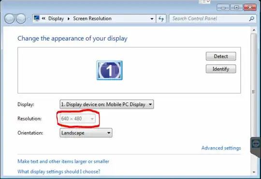

I want to connect to my computer via Teamviewer but the resolution is fixed to 640x480. Im using a RX480 graphics card with current drivers but no monitor.
I browsed through all the threads i could find and tried whatever i could find:
Change in the normal resolution settings is greyed out. control panel

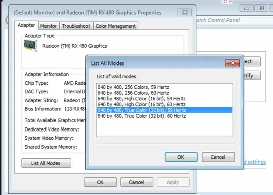

The list in advanced settings only shows small resolutions advanced

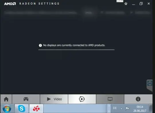

Raddeon settings disable the options with no monitor connected Radeon settings

  • @Darius while i have seen people having problems with teamviewer, at least for now, thatss not part of my problem since i cant get change the resolution of the computer itself which has nothing to do with teamviewer – Eumel Jun 28 '17 at 07:31
  • As to my experience - any remote desktop solution (MS RDP or TeamViewer) - you can't change resolution unless something is connected to it. It will default to the lowest resolution. I don't know why that is the case, but that has been my experience. – Darius Jun 28 '17 at 07:40
