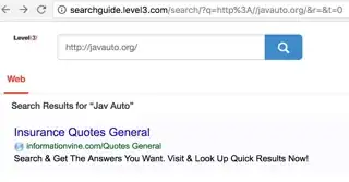

Each time when I type some non-existing domain name in Chrome bar address, I'm redirected to Level3 Search engine.
For example when going to: http://javauto.org, I'm getting the immediate redirect to: http://searchguide.level3.com/search/?q=http%3A//javauto.org/&r=&t=0 with some ads and meaningless results.
I don't know how this got installed. I don't have any Level3 extensions and I use DuckDuckGo as my default search engine.
How can I remove this Level3 search engine from Chrome? As this is very annoying.
Level3 Search Guide in Chrome

    Yes, it was DNS configuration. No any malware. The 4.2.2.1 is basically owned by Level3, and they can do whatever they want, simple as that. Posted the answer here. This duplicate link will only confuse people to look for malware which doesn't exist. This is why questions shouldn't be closed by a single person without understanding the context. – kenorb Jun 02 '17 at 15:05
