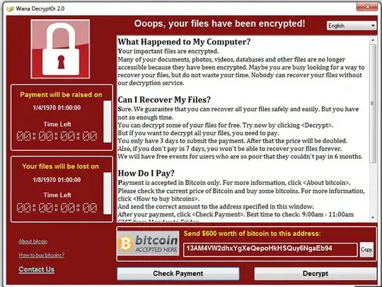

Have you been attacked by WannaCry? No. If you had been, you would have seen a screenshot like this one: WannaCry Screenshot
Since you can still access your computer and use it, you don't have WannaCry.
