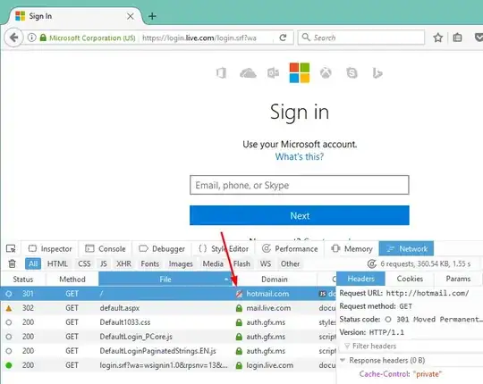

Note that it has *.hotmail.com as well as www.hotmail.com but no hotmail.com, and *.hotmail.com does NOT cover hotmail.com.
So most likely there is some change in Chrome 58 which properly implements this check and blocks hotmail.com. Using www.hotmail.com instead of hotmail.com should eliminate the error.
And the same error is caught with Firefox but since hotmail.com is a 301 redirect Firefox just let it pass but there is actually something wrong.Firefox
