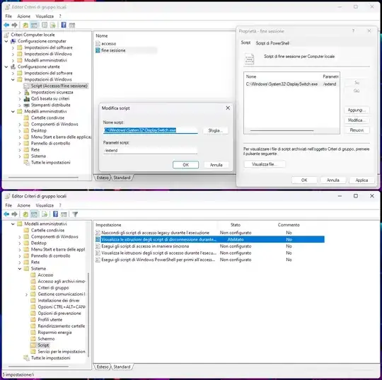

I've finally found out the solution after several months!
  • Open the Group Policy Management Console.
  • Then go to User Configuration\Policies\Windows Settings\Scripts (Logoff).
  • Now add your app or script.
Normally at this point is where it never worked for me.
  • The workaround is to go to User Configuration\Policies\Administrative Templates\System\Scripts.
  • And enable Display instructions in shutdown scripts as they run.
Run GPUPDATE /FORCE and enjoy! For shutdown you do the same steps but under Computer Configuration.
Group policies
