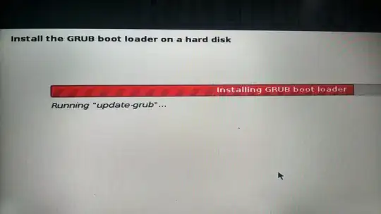

I am doing encrypted disk installation. First partition is /dev/sda1, mount point is /boot and it is unencrypted and second partition /dev/sda2, mount point / and it is encrypted partition. Whole installation went fine but stuck at Install the GRUB boot loader on a hard disk. It's not going anywhere from here. No movement in progress bar.
See image:
Update:
I have just tried to install without any disk encryption and it is stucked again on same step.

Try to do the installation without an internet connection. You can skip some steps that require internet by hitting the esc key and manually select the next step.
When everything is installed you only need to set the repository URL in the sources.list manually.
cd /etc/apt/source.list
gedit sources.list
add the line at the top:
deb http://http.kali.org/kali kali-rolling main contrib non-free
and run the apt-get update, you know how it works.

I hadthe same trouble while doing an install without internet.
That was solved by re-running the GRUB install step:
  1. press ctrl+alt+F2 or etc to switch to another blank terminal session, while in the stuck screen.
  2. kill some of the process later than update-grub, such as the osprob etc.
  3. switch back to graphical install, by pressing Ctrl+Alt+F5 on my pc, you found that the GRUB install failed and can go back.
  4. do install the grub again, that I successfully finished the step.
