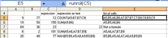

Minimal working example with VBA function unroll(), which takes a reference to a cell with a single function (like sum,count, min) and unrolls its argument (a list of ranges) as a list of single cells.
Option Explicit
Function rangeText(s As String) As String
Dim i As Integer, j As Integer
i = Excel.WorksheetFunction.Find("(", s)
j = Excel.WorksheetFunction.Find(")", s)
rangeText = Mid(s, i + 1, j - i - 1)
End Function
Function rangeToList(s As String)
Dim rg As Range: Set rg = Range(s)
Dim i, j As Integer: Dim c As String
For j = 0 To rg.Rows.Count - 1
  For i = 0 To rg.Columns.Count - 1
    c = c + IIf(c <> "", ",", "") + Chr(64 + rg.Column() + i) + Format(rg.Row() + j)
  Next i
Next j
rangeToList = c
End Function
Function unroll(x As Range) As String
  Dim s As String: Dim i, j As Integer: Dim list() As String
  If Not x.HasFormula Then
   s = "Not a formula"
  Else
  s = rangeText(x.Formula)
  list = Split(s, ",")
  s = ""
  For i = 0 To UBound(list)
    s = s + IIf(i > 0, ",", "") + rangeToList(list(i))
  Next i
End If
unroll = s
End Function
Note: as a minimal example, it does not handle two-letters column references correctly.
* Edit *
Added Function ColumnNoToName to handle cell references with columns > 26.
Option Explicit
End Function
Function ColumnNoToName(colNo As Integer) As String
  Dim lo, hi As Integer: Dim s As String
  lo = (colNo - 1) Mod 26
  If colNo > 26 Then
    hi = (colNo - 1 - lo) \ 26
    s = Chr(64 + hi)
  End If
  s = s + Chr(64 + lo + 1)
  ColumnNoToName = s
End Function
    c = c + IIf(c <> "", ",", "") _
      + ColumnNoToName(rg.Column() + i) _
  Next i
Next j
rangeToList = c
End Function
   s = "Not a formula"
  Else
  s = ""
  Next i
End If
unroll = s
End Function
Function cellFormula(x As Range) As String
  cellFormula = x.Formula
End Function
