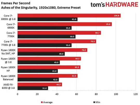

The following example from Tom's Hardware demonstrates degraded performance with SMT enabled:
Tom's Hardware benchmark result: Ashes of the Singularity

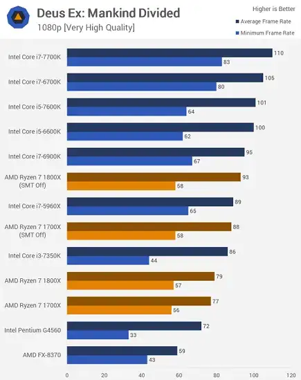

TechSpot did an in-depth analysis of gaming performance with SMT enabled and disabled and came up with very similar results:
TechSpot benchmark result: Deus Ex: Mankind Divided
