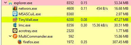

ONE: Process Explorer and Process Hacker can show you the parents of each process. In the screenshot below, Process Hacker reveals that MultiCommander has launched Firefox.
Of course, this is only possible when Firefox is closed and started from scratch, but I think you can manage. You can then use Process Explorer or Process Hacker to locate the sucker that launched the browser and delete it.
Twist: What if the process that you want to delete launches your browser and then end? Here, Process Explorer has an advantage over Process Hacker. Process Explorer remembers the name of that process even after it is ended, provided that Process Explorer is started before the that process ends. (You can right-click on Firefox.exe or whatever browser you use and select Properties to see that.) That way, you can search for a file with that name.
