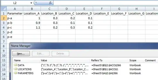

STEP 1:
Name ranges for convenience. PARAMETERS is the list of parameters from A2 on down; LOCATIONS is the list of locations, from B1 across; DATA is the large square from B2 to the end. See my example:
STEP 2:

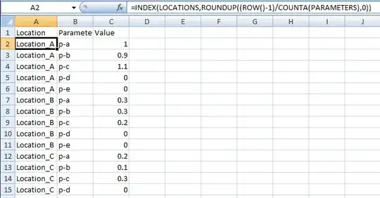

In another sheet, set up your new table.
First column prints out all the locations, and it lists each location as many times as there are parameters:
That formula:
=INDEX(LOCATIONS,ROUNDUP((ROW()-1)/COUNTA(PARAMETERS),0))
That formula copies down.
STEP 3:
Second column prints out all the parameters, and it lists each parameter once until there are no more to list (note that this count corresponds to the count of how many times to list each Location in Step 2). Now you've got your entire list of every location/parameter combination, once each:
That formula:
=INDEX(PARAMETERS,MOD(ROW()-2,COUNTA(PARAMETERS))+1)
