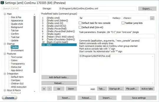

This is VERY simple! Just make a {far} task like so(basically path to your far):

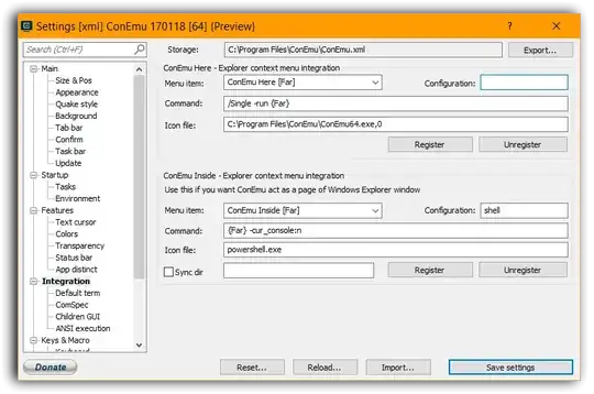

and then in integration tab use these configurations to create ConEmu Far Here:
As you can see in image above, command {far} . runs far in current folder, and then it executes new ConEmu tab with -cur_console:n command. Or you can even configure your task to run with dot as parameter: C:\path\to\far.exe . and then just use it in integration or even from ConEmu command line like so:
"C:\Path\to\ConEmu.exe -run {far}"
and it will start far in current directory, even if called from explorer address-bar.
